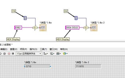

@Lucky-Luka wrote:
Let's say that I just have to deal with double word HEX...how can I adapt my VI?
While there are many definitions of the term word, you probably mean two bytes and thus four bytes per double word. Formatted in hex, each character (0..F) represents a nibble (4 bits), so it seems you want to parse 8 characters into a 4 byte integer. Do you want signed or unsigned? Where (left or right) do you want to pad with zeroes if there are fewer than 8 characters?
The first adaptation would be to change the representation of the type constant to either I32 or U32, depending on your needs and change the indicator accordingly.

6e5a3362-e455-4375-967e-308dc37036b1.jpegYou can do it like this
