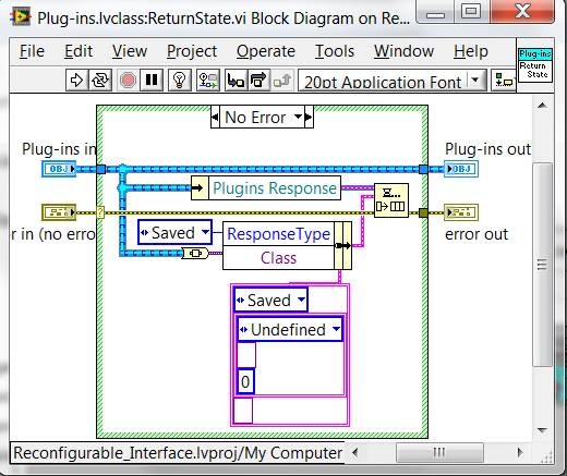

here are images that may help
Ben

ive looked up some things on generic active objects and found some more threads in these forums on their use in labview.  Where can i find those VIs that are in those pictures so i can take a look and see if that is something i can try out and use?  Ive searched my VI library for multiple terms and couldn't find them.  Are they for download somewhere or in a new release of LabVIEW??...i know i have the latest quarterly update installed!

You can't find those (unless I really screwed up).
Those are images of code that I delivered to my customers. You don't want to know how much those will cost. Smiley Wink
After you take a look at what RogerL posted, I don't think you will need mine.
