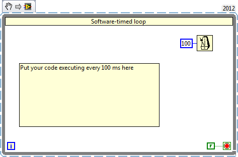

I'm not too sure about what you want to do every 100ms, but here are 2 major ways to time a code :
- The timing functions return when they reach the count wired to their input to make it short. So something very simple just as following will do !
- The hardware-timed codes are more used when notably using DAQmx. You might want to go and check some examples in the Example Finder (Help -> Example Finder -> Hardware I/O -> DAQmx...) and see how they work.
Caveat : In the first solution, if your code takes more than 100ms to execute, let's say 253ms, then the timer is pointless and you'll have to optimize your code to execute in less than 100ms.
