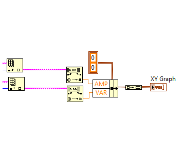

Thanks Apok. This is almost what I am asking for.
The CELL combo box should allow selection of multiple cells, for example when I choose EXP1, I should be able to plot AMP vs VAR for C1, C2, C3.
The other thing is that the combo boxes should read the EXP and CELL column values from the file and those should not be entered manually.
