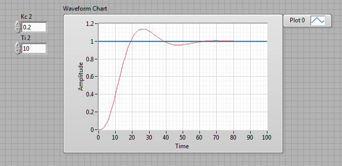

I had to extend the final time to 100s and I put controls on the P and I constants. And by just changing the values, I was able to get this response... and that is why LV is a cool language to tune controllers... 🙂
Barp - Control, Simulation, RTT and HIL - National Instruments

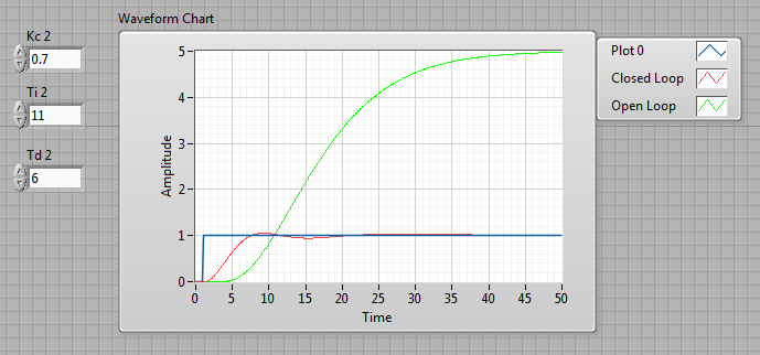

And if you change the solver to RK 1, you can use the derivative action and get this image below. I also plotted the Open-loop response, you can compare both results.

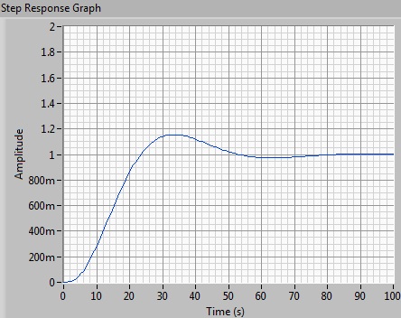

Thanks for the replies which were helpful. I had a go at the tuning by hand. I got slighly different values, I wonder if I made a mistake; I attached the VI below. Kc = 1.2 and Ti = 0.7
I used the Control Design functions and put the linear model with delay transfer function, used CD Feedback and CD Step Response.vi to get the closed-loop. I allowed about 25% overshoot though.

The reason you have values so different was because you used the "Academic" version of PID instead of the "Parallel" version, which was used on the PID Smith VI. The Control Design PID VI has a selector that you can choose the same version. Also, depending of the version of LabVIEW you have, we have a function in the palette that calculates the closed-loop feedback with controller and plant directly. It is called CD Unit Feedback. But your code is correct, though. Notice that you don't need ot wire the second input of the CD Feedback to obtain the unit feedback on that VI.
