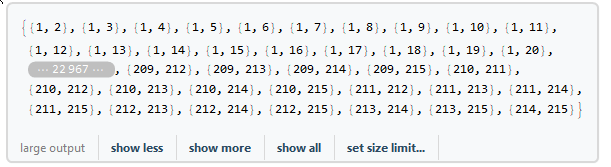

I thought the OP wanted a list of all combinations, ie, something like below for 215 pick 2, not just the size of possible combinations

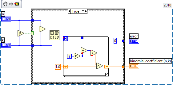

Well, it turns out that LabVIEW also gets the "right" answer.  How?  It basically does the division at the same time as it does the multiplication, so there are as many divisions (keeping the numbers being multiplied smaller) as there are multiplications.  I'm not sure how it manages to avoid "unfortunate" rounding errors when doing the division -- oh, they can probably guarantee an "exact" division by ordering the terms correctly (have the Numerator go from Large to Small, and the Denominator from Small to Large).
Bob Schor
Message 24 of 33
(2,743 Views)
Bob Schor
Well lets not guess
There are a few things I don't understand here like:
  1. since n and k are positive And k is not > n, WHAT is the Min Max doing there?
  2. What happens when n-k>2147483647? Thats a lot of code to generate "1"
  3. What happens when n-k=2147483647? (the last iteration will have a negative denominator won't it?)
  4. Where's the absval for the case 3 bug?
  5. IMHO A Compound arithmetic node would make it a bit cleaner.
Another candidate for NI to lock the BD...
n - k or in other words n minus k goes to Min and Max versus k., Not Max and Min of n and k
So I can answer that question.
mcduff
Show me numbers that can get to that case where n-k>n  we would execute the false case and throw error -23045
Message 27 of 33
(2,729 Views)
There aren't any.
The 1st comparison checks if the numbers are kosher, n needs to be greater than or equal to k.
The min/max determines how many times the for loop runs, assume n =3 k=2, n-k =1
Then the loop would run 1 time, now
assume n =5 k=2, n-k =3, the loop would run 2 times.
The min are different in these cases once it is n-k, the other it's k
Message 28 of 33

The Max/Min is that you are comparing the two parts of the denominator, n-k and k.  You want to "cancel terms" with the maximum number of terms.
