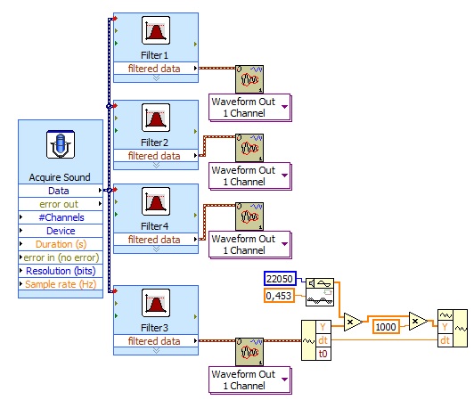

I´m working on my cochlear implant simulator and I have following problem. I want to multiply envelope signals with sine signal. I have tried few ways and checked help. It doesnt help me much. I need it because I want to reconstruct original speech signal. Do you have any clues? I have already spend half a day on this. I have LabVIEW 2013.

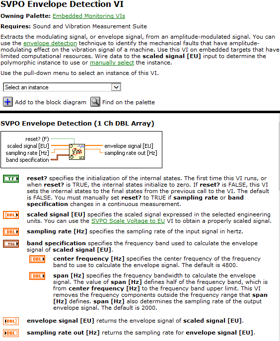

Is my aproach correct? Other question, why I´m not able to play signal from OAT envelope detection.vi with play waveform.vi? 😞

1) Have you tried doing exactly what you just said in your first post - getting each waveform (Index the Data array)  and multiplying it by a generated perfect sine wave? - you are currently filtering the data, not multiplying with a sine wave
2) have you read the context help for playwaveform - have you selected the correct output device, is your sound output on in the OS etc.

Two things:
Try it with a DFT   and inverse DFT 🙂
and mix (add) all your signals first and then send one signal to the sound output.

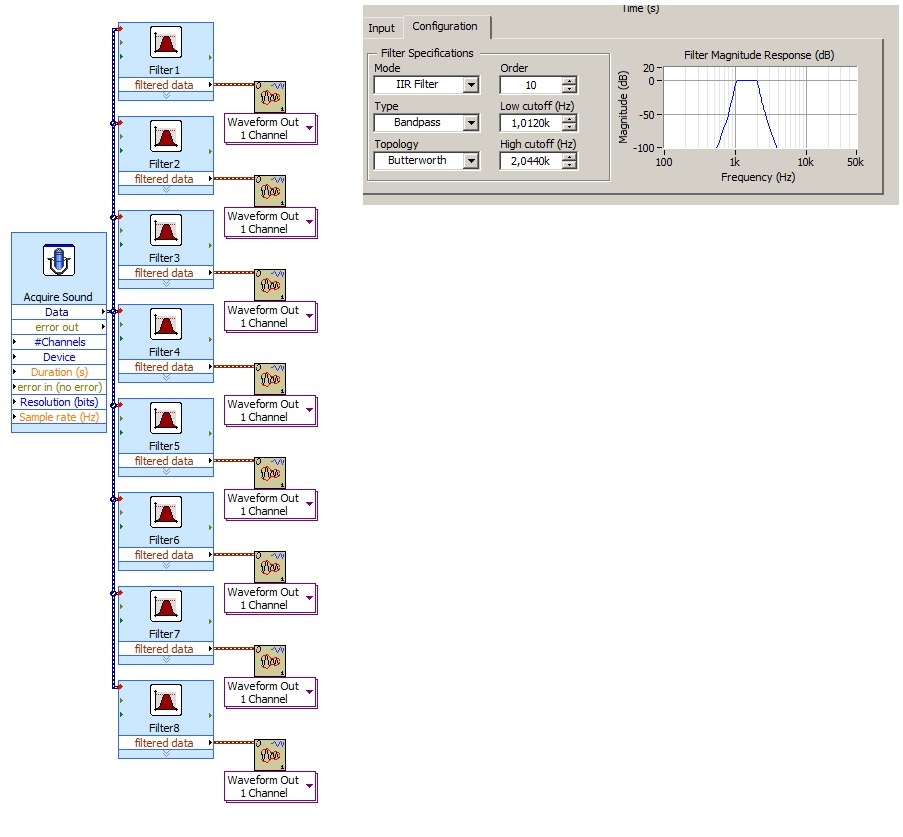

Hello!
I have made some progress.
I generate sine signal with sine wave.vi. I know that i need sine wave array with same length as input audio signal. I set sine wave array with constant samples. But how to correctly set frequency? I know that frequency settings  is the frequency of sine wave in normalized units of cycles/sample. But I dont understand how to correctly set this when I want for example sine wave with frequency 1000 Hz.
Than I need to multiply sine wave signal with envelope signal. Did I make it correctly? It doesnt work 😕
I tried to attach my VI file, but it says 'The contents of the attachment doesn't match its file type.'

Obvious answer:
Frequency = 1/Period
What you are currently doing is:
1) getting your data,
2) multiplying it by a sinewave - when multiplying arrays they should be the same size or you will be chopped to the shortest array.
3) Multiplying the resultant by 1000 - WHY? all this does is apply an arbirary gain to the waveform all the way along.
I believe you are using the wrong function:
look on the Signal Processing > Waveform Generation Palette for Sine Waveform.vi - this produces a sine wave of a frequency and amplitude (among other parameters)
See if this gets anywhere for you.

RTFM H(elpfiles)That really helps 😄
SO: first your output is decimated but you don't need the filter because this vi already do the filtering 🙂
SPAN defines half the filter bandwidth AND the output samplerate.
together with your original samplerate you can now do your sine amplitude scaling....
