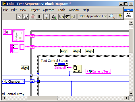

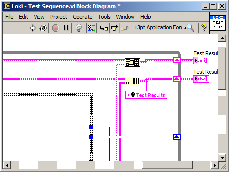

So have done some testing with using a queue to transfer the info to my front panel.  Seems to be working ok though updating cluster elements worked a bit different than I was expecting.  If you only update one element going into the enqueue vi, it blanks out the other element(s).  Was able to work around that.
Added an additional while loop in top level vi to dequeue every little bit to keep the front end updated.
Still using one global var to track load point and this is deeper down so a queue is less practical for that.
Time will tell if this resolves the glitch completely.  Still troubling is why the previous method was causing the glitch.
What I replaced was the two instances shown below where I write to the two seen global variables.  I have not changed any of the supporting structure that feeds the info, just how it gets transferred to the front end.  I really don't see why this would cause an issue unless I am just flat missing something.

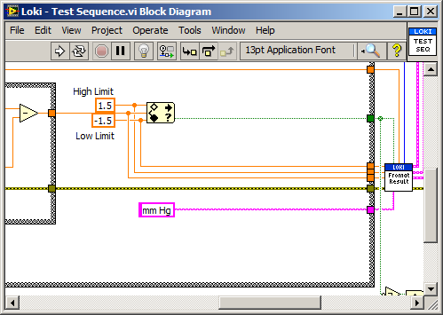

On a side note, I was doing a sequence with highlight execution turnd on in the same lower level sequence vi (before changing to queue) and there was an incredibly long pause (even for the slowed highlight execution mode) when the flow got to the In Range and Coerce function shown below.  Not sure what that was all about.

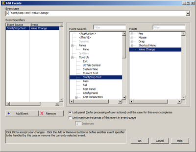

Did you confirm that the event structures are configured so that they don't freeze the Front Panel?
Have you tried using the Task Managers tool to verify this is a system issue? (Spikes of processor or memory usage?)
Let us know. Have a good day.
Luis J.
Applications Engineer
Message 19 of 35
(1,329 Views)
For the event structure ...  freeze front panel, is this the checkbox you are referring too? (the one just to the right of the Remove button)
This is checked, by default I guess since I have never made it a point to change that setting.   The event however is only to enqueue an element and write a global variable (true case that initiates the sequence under scrutiny here).  Thing is, the sequence will start and the display will update for some period before it goes limp.
