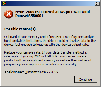

Something new that may or may not be related to display glitch but is driving daq NaN error.  Set up error handler to troubleshoot NaN problem and got this.
This has never occured in probably 6-7 years of running this exact hardware set-up (sans computer, OS and vers of LV).   Is just today started showing up on this new system.   Going to IT to see what they might have done and not told anyone about.
This is a PCI-6014 so it is plugged straight into the bus.  I use a basic scsi cable to tie into a terminal card on the test system itself.
I have to blame this on something with the new computer, either the box itself or Win 7.  My task setup was imported from the previous system so my sample size & rate are unchanged.
Any thoughts ?
I got that last week actually! In my case it ended up being single reads looped too fast, while generating an analog out-signal. Changing to reading arrays at a slower rate solved the issue.

I actually started a new thread for the daqmx error    http://forums.ni.com/t5/LabVIEW/error-200016-Device-mem-underflow-with-pci-6014/td-p/2598053
I increased my timeout by one second and so far that seems to be keeping the error from showing up though it doesn't explaing why after all these years it showed up in the first place.  If the new win 7 computer running LV 2013 is executing faster, seems like it could get away with a shorter timeout.     Just saying..........
