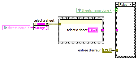

I get error 1 occured in the sub VI '' get sheet data" which states that an input parameter is invalid,
The VI where is the error, reads data from excel file, following the selected sheet. Please see the attached VI.
I wired String Invoke node of Select sheet to sheets name and I used global variables of refnum wired to the invoke nodes.
These global variables of refnums and of " sheets name " are the outputs of the sub VI that allows to get the sheet names.
The problem is that when i run the main VI, it stops because of this error.
Is that because of refnums used in global variables ? Because even when I used them as controls, I found the same error, please help, I've been stucked here for a long time and I can not move forward as I can not get the data.

I debug the VI, the error occured at the output of " item " of the first invoke node of " sheets". I know the function that throws the error but I didn't understand the cause behind this and how to remove it?
There is a race condition with "select a sheet" as the terminal probably is read before the items ("strings") are set…
How can I check the values stored in refnums?
Debug the routines which initialize those refnums to check they are working correctly.
Check for non-existance of race conditions when calling your subVI: are the globals written before you read them in the VI.

I don't think there is a race condition with "select a sheet", the items are set and then stored in the list box, to verify this i add a boolean led,  the " select a sheet " is read after "strings" are set.
Setting that combobox items is done in parallel to reading the current ring value in your VI, so there is a race condition!
To be sure there is no race condition you have to create a data dependency:
Even then it's kind of senseless to set the combobox items as the user has no chance to select any of the items. Why don't you supply a sheet name (as scalar string) to your subVI?

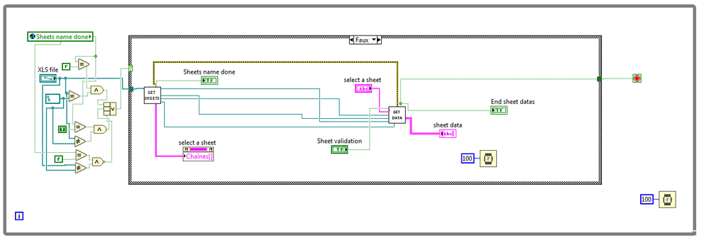

you will find below a capture from the main VI, where there are 2 sub vi, 1) " get sheets" which outputed a string array of sheets name of an xls file, and 2) " get data" which gives the array of data in each sheet. I wired "string" invoke node to the terminal of " sheets name" to feed the combobox with these values, but the issue is that there is a race condition : "select a sheet" is read before that values are written via the invoke node, so there isn't value entred to the sub vi and that's why i could not get the " sheet data " array!
Please, what shall I do to write the strings first and then read the values in " select a sheet" ?
Thank you for your help
