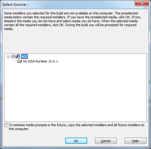

error 100 building installer in labview 2015
The exe can build successful,but the installer build failed.
Error details:
Click the link below to visit the Application Builder support page. Use the following information as a reference:
Error -1 occurred at CDK_Utility_GenerateErrorCluster.vi -> IB_MSI.lvclass:Build.vi
This error code is undefined. Undefined errors might occur for a number of reasons. For example, no one has provided a description for the code, or you might have wired a number that is not an error code to the error code input.
Additionally, undefined error codes might occur because the error relates to a third-party object, such as the operating system or ActiveX. For these third-party errors, you might be able to obtain a description of the error by searching the Web for the error code (-1) or for its hexadecimal representation (0xFFFFFFFF).
The following errors and warnings were recorded during the build:
Error:
*** Abort requested.
Details:
Done building deployment
Code:
-100
(2,969 Views)
Accepted by topic author qingge
So do you have the installer for VISA 15.0.1?  If not, you need to get it ...
Bob Schor
(2,917 Views)
hi Bob,
      I have the Labveiw installer and the NI device drives , so  i uninstall the labview and reinstall Labview and the drivers.
Now,it works.Thanks for your help.
