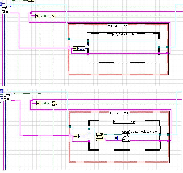

Well Gerd, I tryed here but I can't do it =/
Sorry if I'm asking too much, but the problem is... I want to learn LabView for sure, but I have to make that today!
My boss will travel tomorrow morning and he will need it. This is why I'm asking for help =/
I didn't understand why have 4 cases?
and could you make this example in Labview 7.1?
thanks!
Message 32 of 40
(1,877 Views)

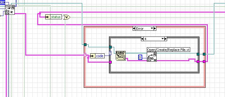

Well Gerd, this is what I did
and at no error I only link the error.
But I'm receiving this message:
"Error 1 occurred at Close file in Mostra 4V4I 480V teste.vi
Possible reasons: An input parameter is invalid"

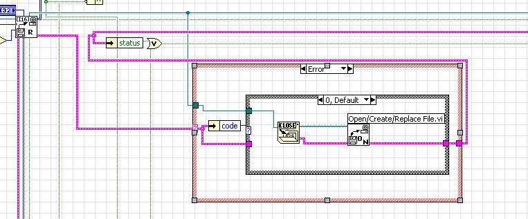

I also tryed it:
but have the same error x( I don't know =/

Hi EduU,
why do you open the same file again? I thought you want to open the next file? So you have to wire the filereference through the case structure too...
You close the file on every error (might be a bad idea), then the reference get's invalid and in the next iteration you try to close a non-valid reference - What's the error reason? Invalid parameter?
Ever tried your vi with execution highlight?
I didn't make 4 cases, I only made one case for error code 4. That's a huge difference!

Yes, I understand it now
I already make only one case to code 4, but I runned it as highlight and when the error was 4, EOF was to use the error case, but it was passing for the no error case... like don't have any error!
well, how can I open the next file? I want to open another one... but i think I was doing that making it:
How can I open the next file so?
Message 35 of 40
(1,861 Views)
Hi EduU,
at the moment you close the file. "Close File" will return the path to the closed file - and you use exactly that path to open the file.
You have to provide the next filename to open! Or should LabView guess Smiley Wink which file to open?
Which error code is given when you want to close the file? Error code 4 is assigned to EOF... When you get different codes you have to check them too. Use a probe (and highlighting) to check that!
