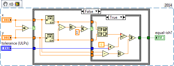

There's a lot of good stuff there. This reminded me that I've had this VI sitting on my hard drive since forever, which takes a slightly different short-circuit approach. The performance looks promising, but I haven't done a whole lot of benchmarking or testing, and haven't actually used it in production code.
The basic idea is to leverage the equality operator to get the Inf/NaN/-0 behaviors, and short-circuit whenever the two quantities are equal. Then check that the exponents differ by no more than one and bail if not. Finally, compute the ULP threshold from the exponent and do the comparison. Other tunings may work better, depending on what your data looks like.
One caveat is that it doesn't allow any tolerance when comparing to zero. That could be handled with some extra logic if desired, but since that situation is ambiguous it might be better handled externally anyway. Let me know what other situations I missed.

Interesting implementation, but I feel the version Altenbach did here probably is faster since it doesn't deal with any floating point math.

Floating-point math itself isn't all that slow--the problem is avoiding the one super-slow operation that dominates. In the other VI, it's the Type Cast (counterintuitive, I know). In my case, I suspected the Mantissa/Exponent primitive. Some very quick and dirty benchmarks showed about a 4x improvement for the full path (and more for the short-circuit cases).
Jim
