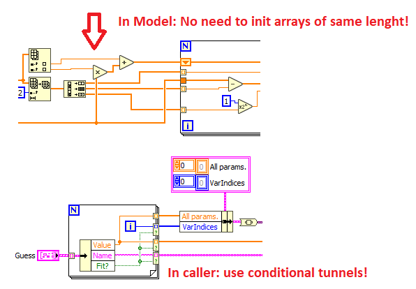

I took your "madness nonlinear project" and change the functions to N gaussians and added a slope. It works great and much faster than formula node!
Thanks a lot. I put it here if some other noob like me needs it !

Looks pretty good.
Two things you should change (see picture):
  1. In the caller, you can use conditional tunnels to build the various arrays (this option was not available when the code was first written)
  2. In the model VI, there is no need to initialize arrays for the slope and offset. Using a scalar will do exactly the same.
The rest looks pretty clean from a casual look. 😄
