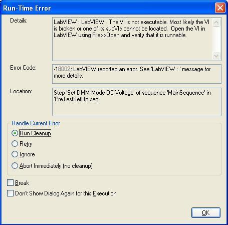

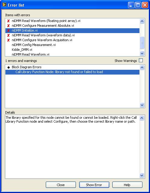

The error is in TestStand, but the origin in in LabVIEW:

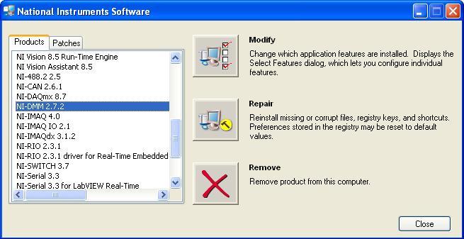

I can't recall what I did the first time I saw this error, but the last three times it happened I fixed it by repairing the NI-DMM installation:
