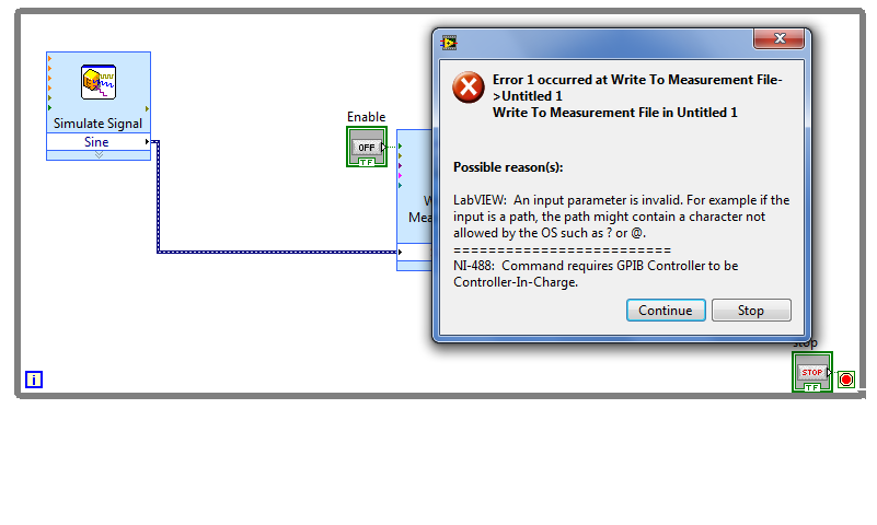

I used to have LV8.5 and vista and never had these problems; now I am using LV2009 and win7
When using the write measurment file express vi I used to get error 1 + NI-488.
I took care of error NI 488 by unistalling the 488 drivers.
Error 1 still persist, but wiring an output error cluster helps so the VI doesn't stop/exit.
And after playing with permission and stuff, I realize the following:
-If I click ENABLE it will stop but after if I click again to re-ENABLE it it will give the error (picture above) and it will say NO PATH.
-if I write a FILENAME while the error is showing and the ENABLE buttons is ENABLE, it will create the file and continue recording.
-I don't get this problem if I used .tdm or .tdms
what make me think that thies express vi can not write/create n its own unless is forced by giving it a new name.
So, nay ideas of what is going on here?

 known issue 179472
The Write to Measurement File Express VI cannot be set to "Save to series of files"
Workaround: Convert the Express VI to a standard subVI by selecting 'Open Front Panel' using the right-click menu for the Write to Measurement File Express VI. In the generated SubVI, set the 'new_file' input/control to be True.
Reported Version: 2009 32-bit    Resolved Version: N/A    Added: 07/31/2009

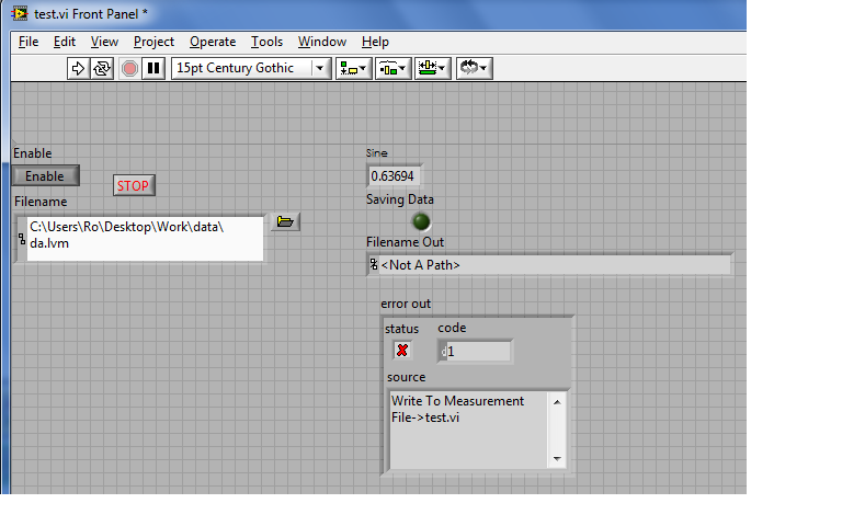

Thank for the help, but I now get this error message:
Untitled 1.vi:1->test.vi
<APPEND>
<Not A Path>
By the way, I am now using the option "Save to series of files", I am using "Use next available file name; I don't know if this makes a difference.

Hi Roddy,
Instead of changing the New File input to True, change the "multi_file" input to true.  Does that work?

I actually the problem by my own. After, I tried everything that I was suggested, I just did the most simple things that I could think off.
My solution: I just copied the express output folder from a labview LV8.5  to my LV200 and somehow it worked just like a charm...
If somebody else need the files, I am glad to send them...

I have had a similar problem. Posted under "Labview 9.0: Error 1 occurred at Write To Measurement File"
I tried your trick of copying the express output folder from my labview 8.5.1 into labview 2009 and now the problem has vanished 🙂
However, is there a bug in 2009 then?
Message 8 of 12
(6,766 Views)
It's bug in LabVIEW 2009. CAR# 192290.
A workaround is to use a case structure to switch between Enable or not.
