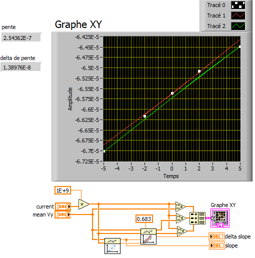

I am trying to fit a straight line, I have done this many times in the past. However for this data (see below) Igor gives me a slope of 254.3 +/- 11.6
In labview, see attached vi, with the same data I get 254.3 (ok !)  with delta slope = 0
Why delta slope is "0" ? As one can see from the data, there is some space between lower and upper limits.
Also, is there a labview vi that gives the slope and the esd of the slope if X and Y arrays have some esd ? (I suspect "ponderation" is to be used, but it is not to me clear how exactly )
thanks for any idea

Hi
Thanks for yuour answer, althtough I don't agree with it. Matthematically, even with 3 points one can calculate a esd of a slope (it has one degree of libherty). Igor and Origin can calculate that, why not LV ???
Anyway, I put 2 more points :
Igor gives a slope of 279.07 with 16.1 esd
LV gives 287. with delta 4.9 E-17 !! (Funny thing, the intercept and its delta is similar for both programs !)
What I am doing wrong ? I have calculate slopes before in LV and all was OK.
For testing with my data, I attached the code here.

You are running into conditioning problems, because your inputs are poorly scaled. Multiply your x-values with 1E9 and you get a nonzero value and then calculate the scaled value back later. (And no, higher order polynomial would make conditioning even worse (e.g. ~1e-18 for the quadratic terms).
(2,760 Views)
Hi
That must be it. Thanks !
(Just a thought : how come Igor -treating the same data- does not have the same conditioning problem ?? Maybe they are adjusting the X values internally ?)
Anyway, that solves my problem
thanks again
