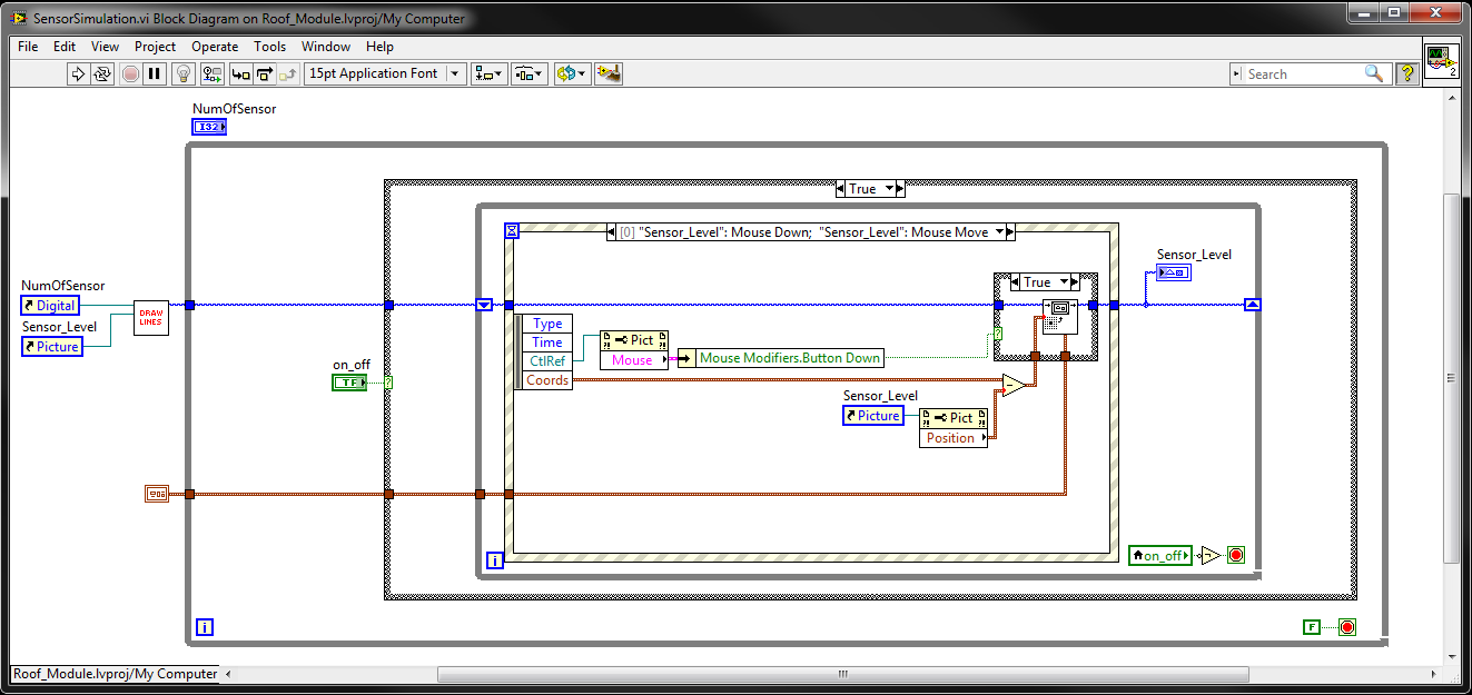

I am trying to achieve an event structure inside a case structure. The event is triggerd by a mouse event (mouse down, move and up).
This vi is trying to simulate a device behavior with some sensor, so the mouse triggered event structure, will not be there in the real working environment, so I can't remove the case structure.
But As I noticed that if i try to click the 2D drawing area (which my mouse events are triggered with) before I enable the boolean condition, I can no longer access any of the front panel component (button, led, etc),
they seems to be frozen. But if the case is set to true before trying to click the 2D drawing area, everything seems to work well.
Is this somekind of LabVIEW bug or it is a limitation?
This are my vis.

Get rid of the outer while loop.  It is an infinite while loop.  How do you end your VI?  You are forced to abort it.
Why is the event structure in the case structure?  What does the on/off button do?  What is in the other case?  Get rid of the case structure.  Use the on/off boolean where needed inside the event structure to decide whether to do something or nothing.

Like what I have mentioned before, I am trying to simulate a device behavior, in this case a sensor array with a mouse event (mouse down, mouse move and so on).
The outer while loop is always there since I am building a non-abort-able standalone application, and so I always use it, and there will be something there later on.
The on-off case structure is to simulate the behavior of the device (ON-OFF), in the real condition this case structure will serve as initialization of the device, later on the device will run inside the inner while loop, where a false condition of the ON-OFF boolean button will stop the loop condition and also will simulate the OFF condition of the device.
Basically i could not remove all the structure other than the case structure, for the mouse event.

Hello Nandha,
Use an Standard Architecture.
I have modified the code. I hope its fine now.
Please find the modified code attached.

Thanks for your modification. So as I understood, if you want to use event based structure inside a case structure, there should not be a condition where the event structure is not running, thus the state machine will always put it to condition where the event struct. is active. Anything else is best to be avoided then.
