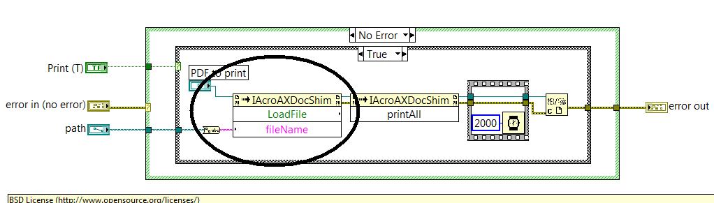

The problem seems to come from the IAcroAXDocShim.  I tried PrintPDV.vi and I got the same error than yours (LV 2009 with Vista).
In the past, this VI worked on this computer but not now. Per curiosity I tried the VI at this link and I have the same error.

I don't know  if this could help you, but I have upgraded Adobe Reader (9 to 10.1.4) and the error in PrintPDF.vi has disapeared.

You nailed it Jean-Marc!  Upgraded Adobe and all is well.  Thanky for the help.
