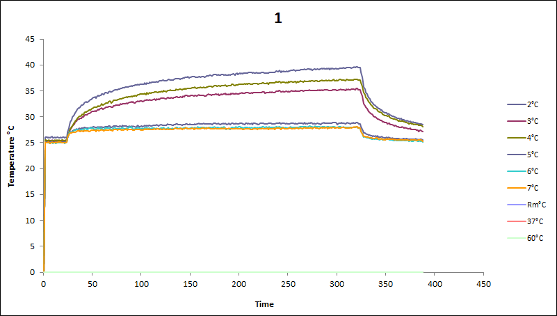

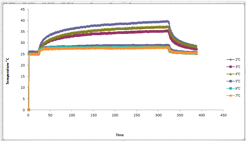

does anyone know how to change the width of the graph?
i want to make the lines smaller or bigger.

I suppose you're talking about the line width.
Using ActiveX: Series --> Format --> ChartFormat --> Line --> LineFormat --> Weight.

Note that in the displayed graph the line width is probably not the issue. It is more likely the fact that you are using markers on data points that are very close to each other. To remove markers use Series --> MarkerStyle and select xlMarkerNone.
