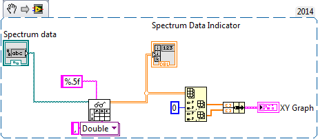

I didn't get far , I got the data from the Excel file using the read from spreadsheet  option but now I would like to have a graph of xy using it and also playing with the number so I need the data to be available for me.
I tried to get it into an array but always have the pronlem that my data is 64 bit and the array is 32 bit.
Unfortunatly I can't be more specific for now.

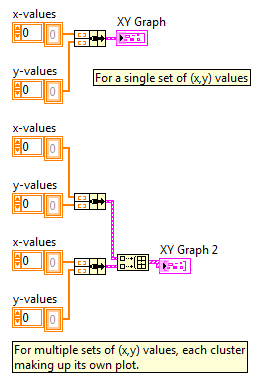

In general, this is how you group values together for plotting to XY graph.
aputman

Here are the steps I said in picture format:

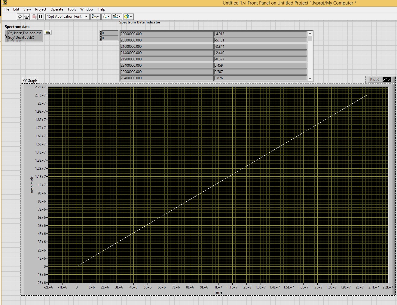

another problem, building like the pic you sent give me the same values on both axis, I have diffrent information on the indicator but it seems that just one axis got to the graph both as the x axis and the y axis.
Message 8 of 10
(8,195 Views)
Please show the block diagram
Message 9 of 10
(8,191 Views)
you right , the "0" wasn't connected correctly.
