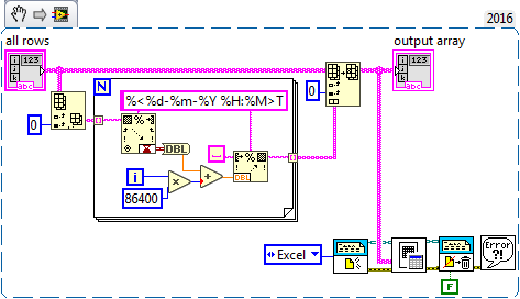

I have the same problem with the dates from jan 1st to jan 12th. It is Excel autoformatting the dd-mm-YYYY H:M format to mm/dd/yyyy h:mm. (I have a French version of Excel 2010). Up to jan 12 Excel uses one of its pre-defined format and switches day and month and use 12h time.
This autoformatting can be disabled by adding a space in front of the date time string. I can't see how RavensFan implemented his version (I don't have LV2017) but here's my simplified version of your code.
Ben64
