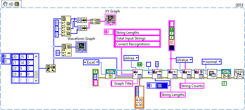

My apologies.
I had used that "Close" option in the Dispose Report VI, but in my initial program I had it "False".
And in the later programs, somehow, I do not know what happened, but it didn't close. I must have some other error or whatever. So I thought the option doesn't function. And I thought the option was for to close the report manipulation, and not close the window.
But just set it to T (or left it without anything, as the default is T), and it closes. Removed those workaround things.
I didn't post the code because I was just quickly replying the message, and didn't have time to post a sample code out of the application without dependencies.
But I usually post questions with my code only.
To show my mistake, posting the program here.
In that second last node, if I remove the boolean constant "F", the report file is closed.
Vaibhav
