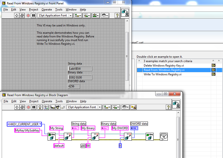

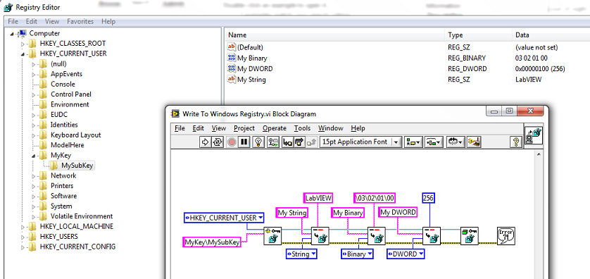

I don't understand your reluctance in using the registry. Instead you prefer to "spend hours looking for detail on the forum" for your choice of using the ini in the exe trick.
Your original post was asking how programs 'remember' settings. Using the registry does just that!! As your program exits, write the relevant values to the keys. When your program starts next time, read those values back in. And there you have it - your program has 'remembered' the settings - no ini in sight.
You can have a case structure at the start to check if the keys exist, if they do then read them, and if they don't then create them.
 It's easy, just use the shipping examples:
