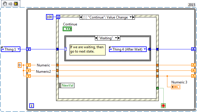

Accepted by topic author arvin1947
I would highly recommend you implement a state machine. It may work for now to just cycle through a for loop, but I think later when you try to add features to your program, you could have problems. For example, what if the user wants to stop the program completely instead of continuing? It will be difficult to add if you just have a while loop spinning and waiting only for the continue button.
Here is how I would modify your code to work as a state machine. Notice, how I've added the ability for it to stop at any time if the user closes the VI.
This uses an event structure, which I highly recommend. I think it makes it very flexible in that you can respond to any event easily by changing your state.

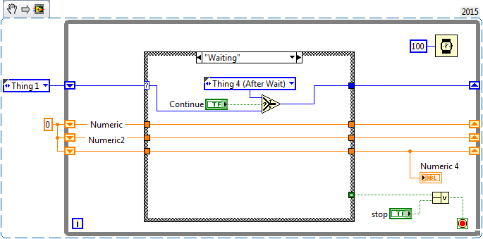

If for some reason you don't want to use an event structure, you could do it with polling as well, like this, but I don't think it's as flexible. It does at least give you the ability to stop midway through though.
