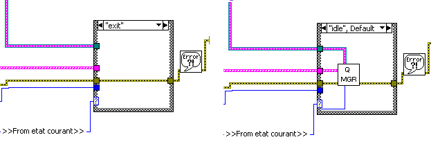

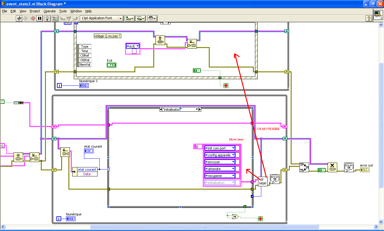

Well..
I was not able to get events you have registered with event structures. And also couldnot understand properly because of french texts.
Anyway, you are facing this problem due to the STTM Q MGR_new.vi in the consumer loop. You are queing more elements in each iteration. This causes your loop to hault untill this vi finishes execution although you have dequed exit case in the end.
So is it really necessary to have this vi outside the case structure? cant you use this vi to que elements in the producer loop? (loop above?)
. Or you can queue required elements inside the case structure of consumer loop.(Place this vi in whichever cases necessary)
As shown in the figure,  move that vi either inside the case, or you can just que those when the user action takes place in the producer loop.
  I hope i am clear in what i am trying to say. Your lower loop will never stop untill the STTM Q MGR_new.vi stops its execution, so it is necessary to meve as mentioned in the figures

Or another simple solution would be, put a case structure around the vi STTM Q MGR_new.vi, and donot execute this vi when output of the deque element is Exit.
