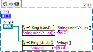

As nyc said, either of these properties will extract the strings from your ring

Yes, you can read it that way, but not write.
With rings you can write it that way, by property node, even at run-time.  Enums you can't write at run-time Rings and combo boxes you can.  Some minor points but well worth knowing.Smiley Wink

Sorry, I wrote this VI a long time ago. The label says ring but it is an enum.
