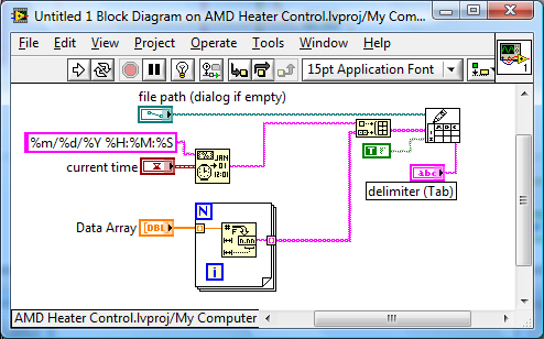

What about writing one row at a time as you acquire the data? Such as:
I didn't look at your code but thought I'd take a stab based on your description of what you're attempting.
