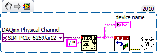

I think this might be the "trivial" way you're looking for: some string pattern matching and a simple
regular expression to extract the device name prefix from a physical channel name.
-Kevin P

That is indeed more like I had in mind. I wasn't sure I could fire what looked like an enumeration type into a string vi. I guess it isn't an enumeration, just a string after all (in which case why isn't the wire pink?). Thanks to both respondents. I've tried both and they work - great.
