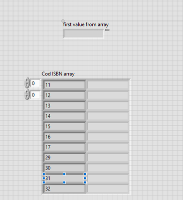

here you can find some screenshots . could you guys help me because i m kind of blocked here and i need to present my project xD
just the first column is populated. i have no experience with labview, but i need to simulate something using labview and codesys, the connection been made using OPC. thanks guys

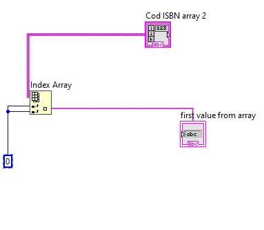

Simple like that:

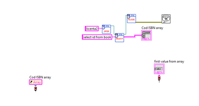

i need to use the reference because i am extracting data from my database ( SQL ) using select, and in my main program, I call the sql function everytime i press a button. Long story short, but i am trying to accomplish here is to simulate the returning of a book automatically using codesys and i need to extract a code ( ISBN CODE for the book) in order to update my sql using delete, insert update etc.
As you can see in the screenshot below, i dont know why, but it's not working, as you can see bellow
trying to replicate my array :
 that s what i have done before posting

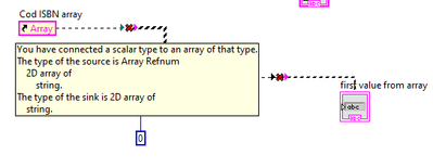

trying to use the reference ;
As you already took some courses (did you?) you know the purpose of control references. A reference is like a pointer to a control, but it is NOT the value of that control!
LabVIEW comes with a huge example library, and there are examples explaining how to use references!
  • Basically you need to use a property to read the value of the control referenced by that reference.
  • Generally it is a bad idea to use references when a simple wire would work too…
(4,434 Views)
thank you very much, using the property worked perfectly for me, appreciate your efforts trying to help me 🙂 thank you again
