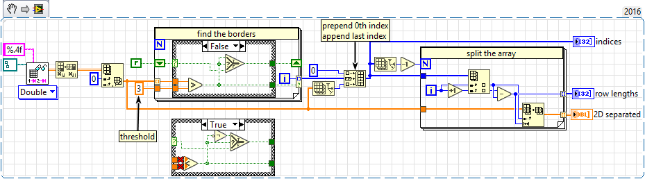

Hi Sarah,
search for the beginning of each ">2.5" part/"signal", then search for the end of this part. Use ArraySubset to get the part. Put all this into a loop…

Accepted by topic author s.steen
Do note that if your pulses are not the same length, your shorter pulses will be padded with 0 at the end when you change to a 2D array to keep all of the rows the same length.  But this code should do what you want.
my try, crossrulez beat me to it 😉
EDIT: fixed corner cases

The ">2.5" part is explained in crossrulz' snippet!
