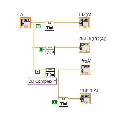

hi
see this vi it's completely match with matlab code.
it's may be useful for you.
