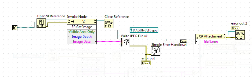

This is the snippet of a VI thats creates a screenshot of a certain VI front panel, saves it to disk and then attaches it to an email.

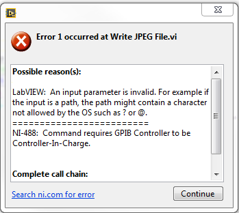

email.PNGnow this worked one time, the second time i get
Error 1 occured in Write JPEG file.vi
Possible reason(s):
LabVIEW:  An input parameter is invalid. For example if the input is a path, the path might contain a character not allowed by the OS such as ? or @.
NI-488:  Command requires GPIB Controller to be Controller-In-Charge.
Complete call chain:
     Write JPEG File.vi
     CNHT_v8.lvlib:Email Notification.vi
i cannot modify the .jpg file anymore, it is "opened by labview". I suppose there is some open reference conflict, but i have totally no clue how to find that open reference and close it. can you help me? Thank you!

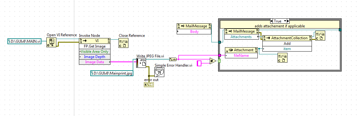

I found the problem is in the attachement function. I cannot make it "close" the file anymore, or let it go. Do you know how?
this file may help.

I hope you might have taken the code from here : Sending SMTP Email Attachments from LabVIEW : https://decibel.ni.com/content/docs/DOC-7451
-Can you check by moving the Close Reference for Attachment after the Attachment Collection.
-It would be nice if you post your VI.

I think Uday was on the right track, talking about the close used to destroy the attachement node. Wiht the way that code is wired, LV COULD schedule the "close" to occur before "AttachementCollection" node executes. That would invalidate the reference and trigger the error becuase you have to pass a valid references that has not been closed.
Try to run the errror wire from the "AttachementCollection" close to the input of the close used on the "Attachment" close to force the close of the reference to happen after all of the others stuff.

I doubt this is it but you might want to use some data flow, and ensure that the attachment reference doesn't get closed until after AttachmentCollection is done with it.  At the moment you are closing that reference in parallel to adding it, would could be causing trouble.

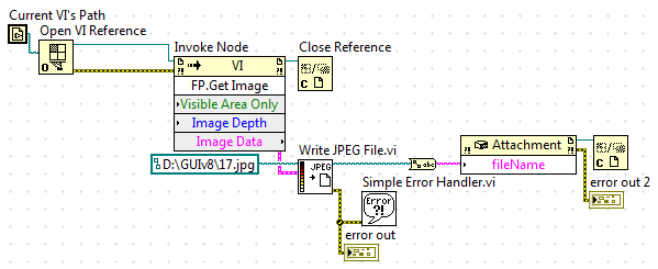

Dear all,
thank you for your replies. If this forum allowed me to edit the initial post, you would not need to point out things i already excluded from being the cause of the issue.
My wrapup:
If I run this code (see attachment):

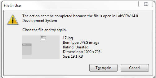

The front panel screen is successfully saved as .jpg. But it is also opened by LV. Any attempt to delete or rename the file results in this dialog (Windows explorer):
However I am allowed to open/view the image.
running the VI a second (and any additional time) results in the following error:

-removing the "Attachement" function from the block diagram cures the problem
