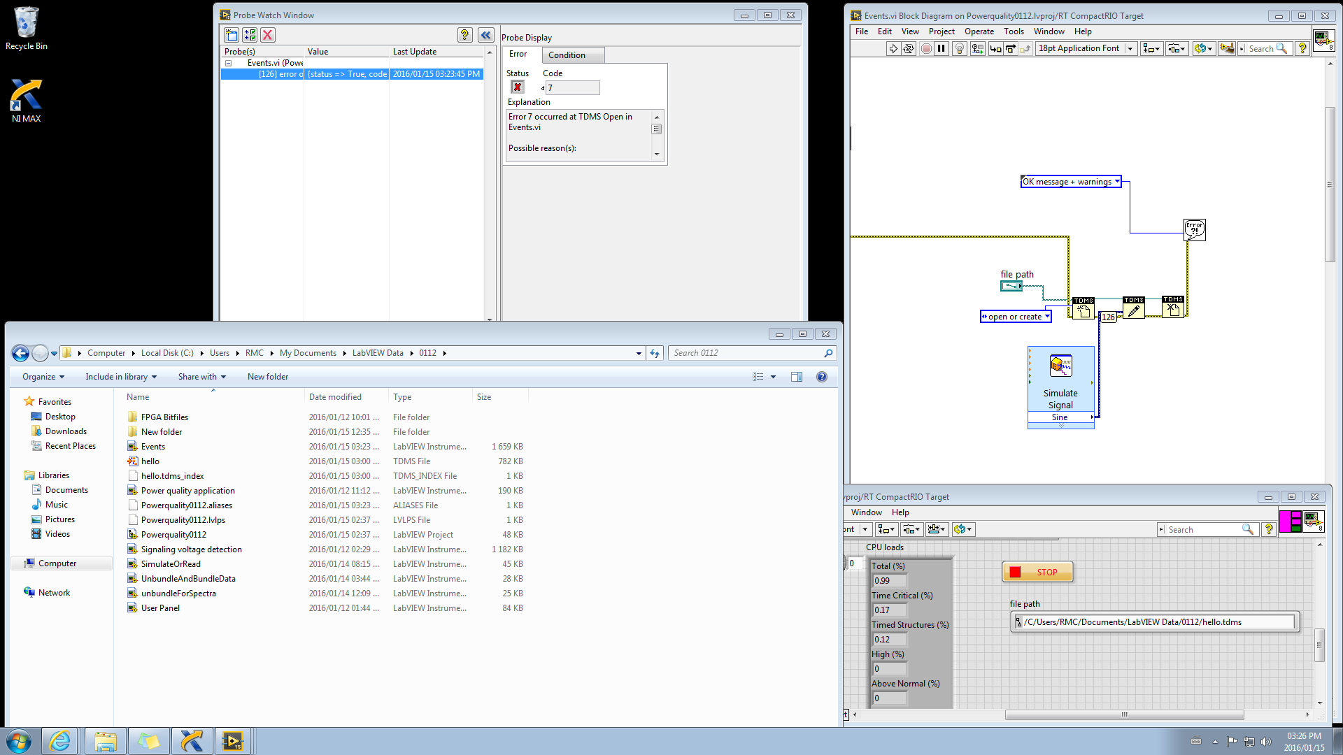

I have been trying to write a file path so that I can create a tdms file to write data to.
The problem is that when I start to type the path namely:
C:\Users\RMC\Documents\LabVIEW Data\0112\hello.tdms
the file path indicator adjusts it to:
/C/Users/RMC/Documents/LabVIEW Data/0112/hello.tdms (Though when copying this it changes back to the original).
I have tested this on other VIs and other projects and this does not occur.
My goal is to write a tdms file however it will not open the file as it says that it cannot be found (Error 7 occurred at TDMS Open in Events.vi  LabVIEW:  File not found. The file might be in a different location or deleted. Use the command prompt or the file explorer to verify that the path is correct.) and this is the only reason thing I can see that is different from the other VIs. I also dont understand why it says that the file cannot be found as I have set TDMS Open to create one not open one.

Hi there,
I am adding a screen shot of the snippet of code. I created the tdms file hello using another VI (just to test that it is possible). I am just trying to send it a simulated signal to see if it can open and write into the tmds file:
Message 4 of 9
(7,535 Views)
I have tested further and my problem only occurs when the project is open, when I create a VI in the project it does not work. If I close the project and open only the VI it works.

Accepted by topic author JanelleTheron
You have the VI listed under an RT target and not 'my computer' - hence why I asked about that. It's trying to access the C:\Users\RMC......folder on the target, which doesn't exist. You need to save the file to a valid folder on the target or run the VI under 'my computer' by moving it in the project. The /C/Users format of paths is used on RT targets. When you open 'just' the VI, it always runs on your computer - you'll probably notice the path changes back to a windows path (e.g. C:\Users\RMC....).

Hi Janelle,
your cRIO cannot access the harddrive of your PC! That's it...
Message 8 of 9
(7,496 Views)
You need to think of your cRIO as another computer.  You don't expect your coworker's computer to access a file on your computer, do you?  At least not with "C:\".  Typically, you will want to make a Windows application as well that can get data from your cRIO and save the data.
