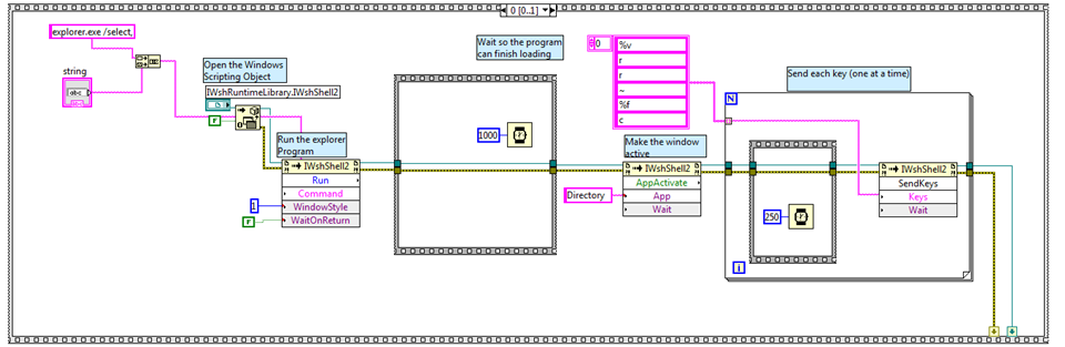

I don't know if this was ever resolved, but I wrote a little script that will launch a new explorer window based on the directory path you input.  It then refreshes the directory view, then closes the window.  My data logging program can now be programatically update the size of the log file.  Unfortunately this opens up a new window every 5 seconds (the update rate), then closes it.  The other frame simply has indicators for the Reference Out and the Error Out data.
There must be a better way...

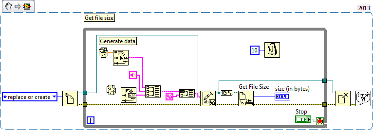

Hi!
You can use the Get File Size function, I have attached an example file below and a snippet for easier viewing.
It is also possible to execute a Windows command line from the System Exec function, giving you the option to run silently (minimized). Have a look at this KB for more information: http://digital.ni.com/public.nsf/allkb/8E19CA81874FFDD786256BE40066C151

That worked perfectly.  Thank you.
(3,710 Views)
