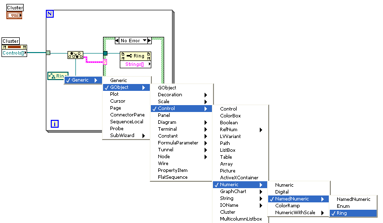

How about this?
Of course, you could also just click on the ring inside the cluster and create a property node linked directly to it.
