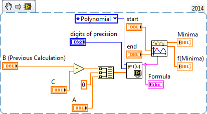

Hi, generate the string based on the polynomial coefficients could help you. Your polynomial is always of the same degree?.

The VI is attached. It's a snippet.
(3,280 Views)
You can drag the code from the snippet onto your block diagram
