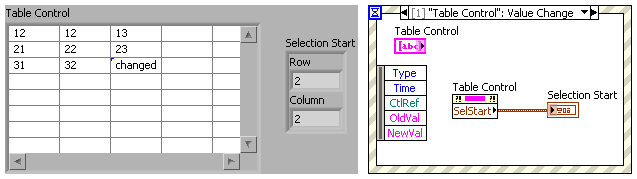

There is probably a better way to do this, but this is a brute force method:
20667i78F92A56CAEB3C38
- tbob

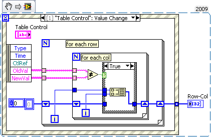

Yep, there is a better way:
20669i35AA3D1CD7AC969B
- tbob

I know this is an old thread, but I found an issue with this approach.
If you change a value and instead of selecting enter you click somewhere else on the table then you now have a value change event and your selection has changed, giving you the incorrect selection start.

Rather than using the selection start property I would suggest using the EditPos property, as this tells you which cell you're actually editing.
This still has the same issue of showing you which cell you're currently editing, so I would suggest having a timeout case in the loop and reading the property in the timeout case (let's say every 100 ms). That way, when you get the value change event, you can use the EditPos value you got during the last timeout, which is probably the actual edited cell, as it's unlikely the user had time to give the cell focus and edit it in under 100 ms.
This is still somewhat flaky, so I would still consider using tbob's method, which could also be made cleaner by being made into a subVI and using a conditional stop.

I´m not a big friend of tbobs solution though, because the table might get bigger over time which might add
to the execution time. Even with the conditional stop.

If you want to have both safety and performance, you can use a combination of the two ideas: Use the timeout case to monitor the EditPos and whenever it changes add it to a circular buffer with a few elements (for example a queue with a lossy enqueue or an array which you modify using Rotate 1D Array) and when you get a value change, check just the positions in the circular buffer to see which of them changed. Ideally, it will always be the last one, but just in case, this lets you have access to the last few cells you edited.
