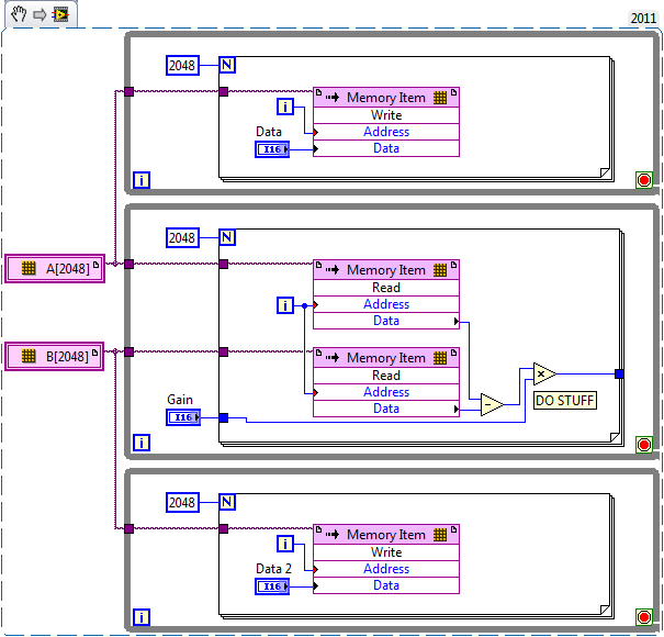

Unfortunately, the LabVIEW FPGA compiler cannot infer embedded memories from arrays (yet). When you create those two large arrays, you are essentially creating several very, very large registers. Just glancing at your image, I would guess there are at least 4 copies of each of the arrays.
You will want to use LabVIEW FPGA Memories instead. You can create the memories outside the loops and then read/write them where you are currently referencing the arrays. The only change you really need to make is to break your processing down into scalar operations. I have attached a simpler version of your scheme, I hope it helps. Let us know if you have any more questions.

Hi Dragis,
thank you for your suggestion and template. I just implemented your solution and the first compiled VI seems to work.Great, you made my day!
