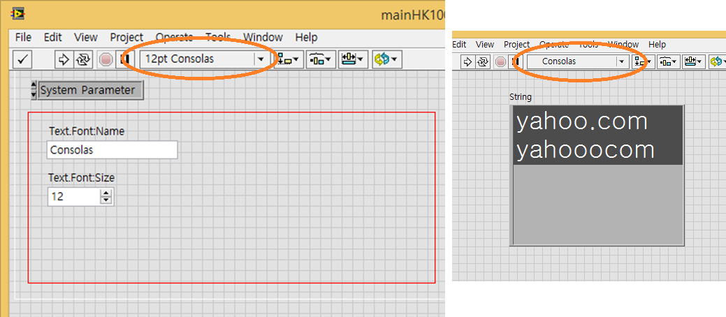

Just out of curiosity?  With that font what is the differnce in the space (width
0 of a hyphen - and an M-dash (Atl+0151) —
Yup, Consolas isn't truely monospaced
the "N" and "M" dashes are clearly of seperate widths.

Labmaster: Attached to this post is a VI with a control on the panel that uses Consolas. The VI is saved in LV 2013.
It displays correctly on my machine. Open it on your machine and see if it works. If it does, then it is a problem with how your string control is set up. If it doesn't, then there's a problem with your machine somehow -- LV uses system calls to do font rendering. I don't know anything about that layer of the software though, so I can't help beyond that.

Sorry, I have no LV2013 and thanks for your effort for me.
If you can covert it to version of 2012 or lower, I am happy to review it.
However, my problem isn't still resolved.
I guess this is related to my language windows irregardless of LabVIEW english version.
I am sorry to everyone except NI for posting my problem agressively a litle bit but this problem was reported in several years ago.
But nobody commented about this.
I felt I was grabbed in a fishing mesh again after my last bug report without any NI's compensation for the incompleteness.

The font size is missing on your panel while all characters all selected.
That usually means there are at least 2 differenct font sizes in your string.
Double check font size.
