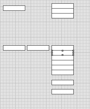

I have some form that user will fill that has many string and enum controlls, more than 40.
User wil tab and fill one by one. I want to set focus on controll when user clicks on it.
I don't want to make more than 40 event cases and service each control in separate way.
My another idea is to get refs and positions of all controls on FP, then monitor mouse click event on FP, get click position and then search for that controll.
But maybe there is more elegant way that I am not aware of ?

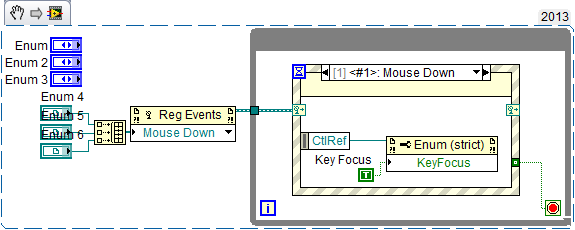

Hey Pawhan11,
You could place all references in an Array and register for an mouse down event. In an eventstructure use the Dynamic Event to modifyy the enum you clicked.
CMW

Thanks Member CMW..
I tried dynamic event but I registered all events in separate way  and it didn't worked  like I wanted 😄
You'r code makes it 🙂
Big thanks! , problem solved

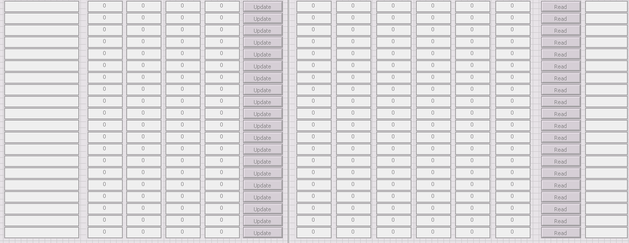

Looking nice really depends on how you use the Tools palette to make the arrays better.
Sample Array Controls
(4,651 Views)
I know but this form fields have to be placed in many many diffrent places - like that :
And belive me - this was not my idea 😄
This form has to be saved to pdf and printed. So I wanted to use exaprom pdf addon. But there was problem in creating table with so many fields in different places ( cells had to be added one by one with diffrent colspan and border type...  and that would take ages) So I put every page on invisible tab controll and printed that tab as an image to pdf. Text is not as vector but as image. The best part of it is that quality of that was acceptable 😄 😄
