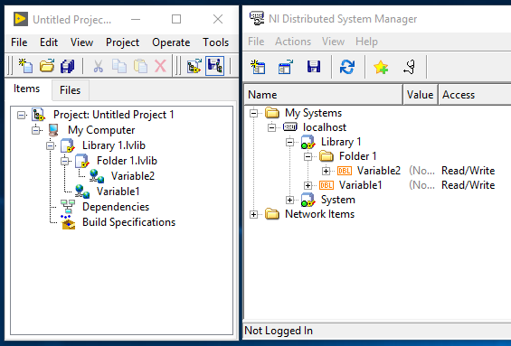

folders in DSM
Under the SDI12 process, how does one have a folder structure in a DSM process as shown in the picture?
I have not been able to google search anything useful nor find anything in the help files thus far.
Thank you in advance.

It looks like it's created using a nested library in the LabVIEW project. I couldn't find a way to create the folder / nested library within DSM.

ahhhhh....
Thank you! Good sir!!
I take it I would basically need to search for the library(s), modify it, and deploy it, if I want to make updates to that on the localhost in DSM?
(2,277 Views)
Yes, I think so.
