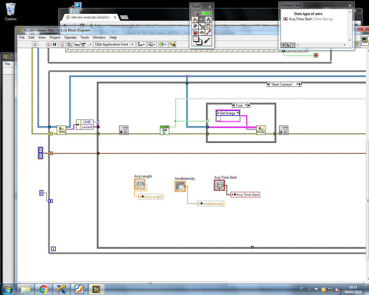

force execution flow
I am a newbie just arrived from VEE, so please be patient.
In VEE I always have sequence-output and sequence-input pins on any bow that allow me to force the execution of a box.
In labview instead I dont see those, so I guess the execution order is always data-driven, correct?
Now, I just created some local variables where I want to store some internal informations, so I have the objects in the front panel, and the "set local" connected to them in the flowchart:
(as you can imagine, I'm modifying a complex program, I didnt write it...)
Now, since these couples: "Acq length", "timeIntensity", "Acq Time Start", as a whole doesnt have any input/output, I dont see how to force their execution. In fact, they are never executed ...
what am I doing wrong? Thank you for your help...

You are correct that data flow is the primary mechanism for determining execution order (although there are also things which can add delays, such as the dequeue element function in your code, which will wait if the queue is empty and will only continue when somewhere else in the code a value is added to the queue). Error terminals are just a specific case of this principle.
I'm not actually sure about your question. You say that they "don't execute", but they would. The code just doesn't do anything, since you're simply reading the value from the control and then immediately writing it back in. There's nothing preventing you from creating additional local variables for the same control and using them in the other cases.
That said, you should be careful with that, as it makes it very easy to create race conditions. The most common answer to your question about accessing values in other cases is a shift register, which passes a value between the iterations of a loop. You could create a state cluster holding all of the current relevant values and then bundle and unbundle it (by name) in the relevant cases. This isn't functionally different from using locals, and it has some disadvantages of its own, but it's generally preferable and makes it harder to create race conditions.

You're on the right track, except that the error in and out is just another example of data flow.
LabVIEW data flow can be summed up in two sentences:
A node will not execute until all inputs are satisfied.
A node will not produce an output until the node has executed completely.
When you boil everything down to basics, those are the only things that determine data flow.  If you take those two statements literally, any case where it seems that the order of execution is ambiguous really is ambiguous - and you'd better fix it if one node actually has to execute before the other.
