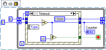

Use an event structure with a 15000ms timeount and an event for the stop button. Pressing stop will immediately break the timeout.
Here's what I had in mind (LV 8.5).

@altenbach wrote:
When I saw the image I didn't understand. The wire to the sandclock is hidden I have corrected. 🙂

Thanks, the wire must have slipped under there unnoticed when I resized things for the final save.
