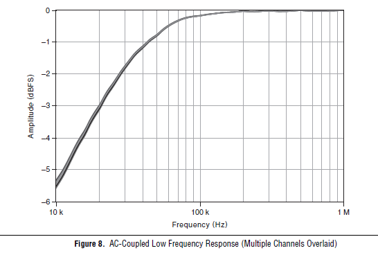

Unfortunately the 573x FlexRIO adapter modules are all single ended so we won't be able to change them to differential. What is the frequency of the signal that you are trying to measure? Another option would be to set the 5733 to AC-coupled mode which would yield the following frequency response, greatly suppressing any noise below 10 kHz.

The frequency content of the signal I am measuring depends on the instrument I have it connected to. sometimes the bandwidth of interest is 0-5kHz, and sometimes it is ~300 kHz. So I cannot use the AC coupling. I'll try to add some filter in my FPGA program to remove the 60 Hz harmonics. Thanks for you quick response.
