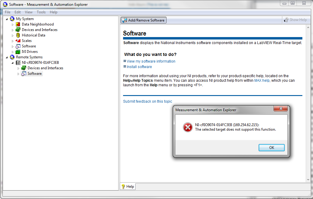

Sorry,
it was a mistake on how I named the question.
In the picture you can see the error:
(3,818 Views)
Perhaps you should try the technical support referring to this post.
Br,
/Roger

Hi
It could be a problem with the RIO driver, so I would advise you to try out these suggestions
-Repair their current RIO-driver
or
-Upgrade the RIO driver to a newer, compatible version
or
-Remove/unistall the driver and reinstall a new version
You can find the RIO-driver at NI.com/drivers
Regards
Espen
AE, National Instuments
