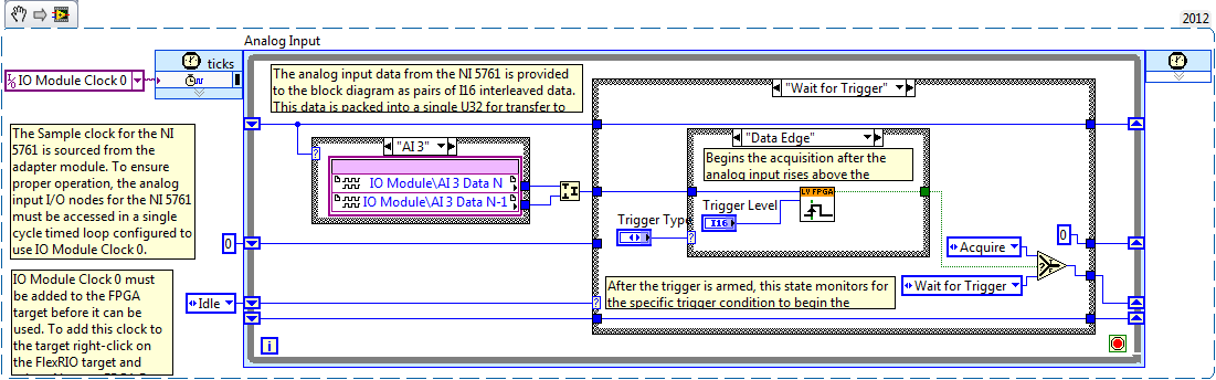

The NI 5761 examples installed with FlexRIO support for NI-RIO have an example of setting a Data Edge trigger based on an Analog Input value rising above a trigger level. This example can be found in <LabVIEW>\examples\FlexRIO\IO Modules\NI 5761\NI 5761 Getting Started. From here, open the NI 5761 - Getting Started.lvproj and look for the Getting Started VI under the RIO target you are using. The trigger loop looks like this:
The NI 5671 manual also has a good walkthrough of setting this up. You can find a PDF of the manual here.
