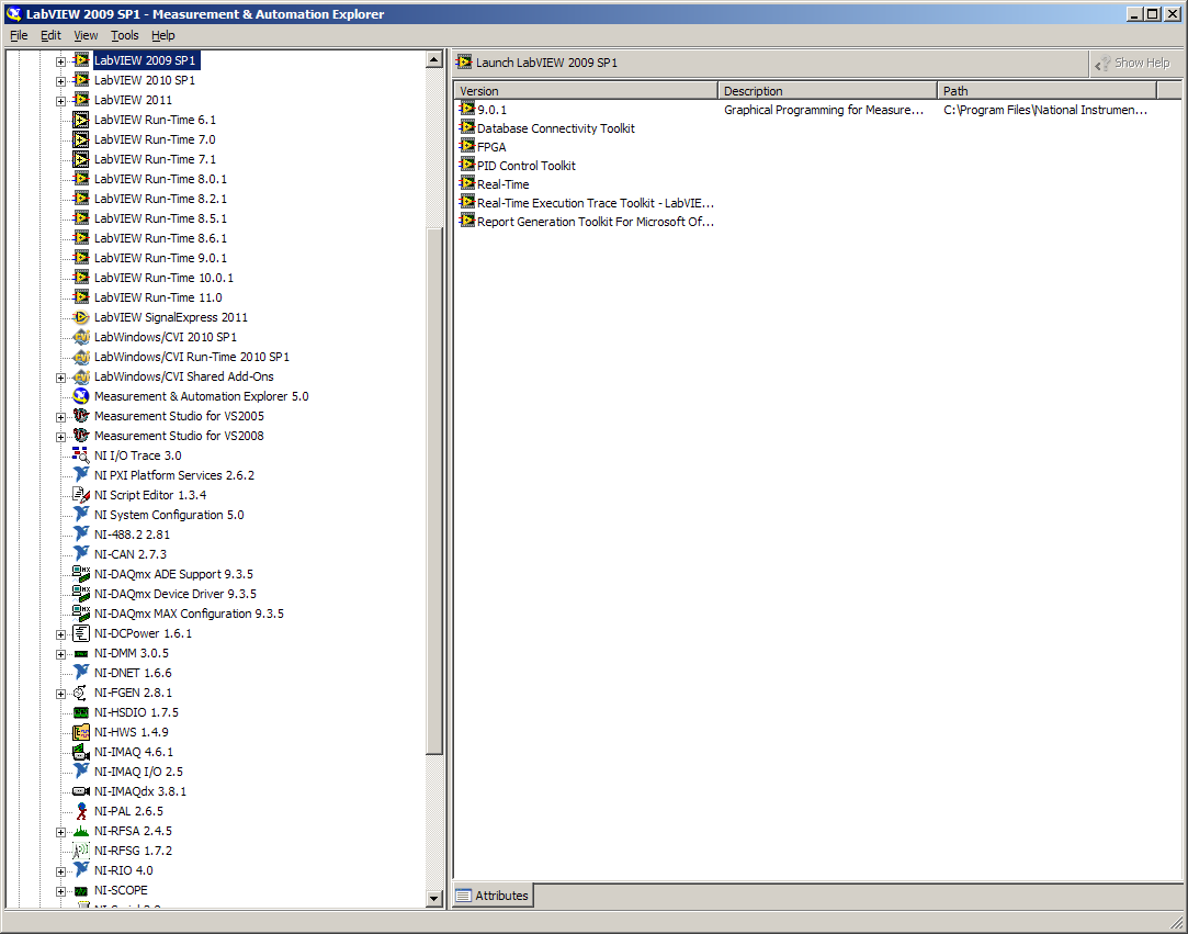

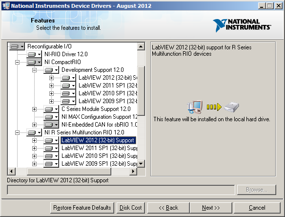

Open Measurement and Automation Explorer, and look under Software.  You should have LabVIEW and the FPGA toolkit, as shown in the attached screenshot.  You should also have NI-RIO, also visible towards the bottom of this screenshot.  If you have both of those, try reinstalling the RIO device driver, and make sure that you include support for the LabVIEW version you are using, as shown in the second screenshot.
Message 6 of 9

You need to install NI-RIO (Reconfigurable IO) from the Device Drivers DVD.  Make sure you include support for LabVIEW development, as shown in the screenshot in my previous message.
