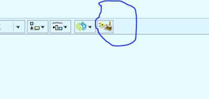

Meanwhile ,the "auto-clean"button of some of my VIs(top VI and some subVIs) do not work. if I "auto-clean" the whole diagram of it , nothing will be done, if I "auto-clean" part of the VI, other parts will be more disorganized(or even some error appears), I donot know if there is any relation of it with the annoying "debug file"!1_副本.png
