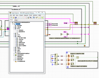

Following an fpsane.cpp error, all open vi's crash and when they are reloaded they are temporarily reloaded in mandarin chinese. After a minute or so the language reverts back to english. Has anyone ever seen an error like this before?

I have seen such an error message couple days ago. Most of the times I couldnt even open the VI as labview has crashed right away. Sometimes I could open it but crashed when I have tried to save it. I have submitted my VI to NI, no response.
I assume the file got corrupted somehow as I have rewritten the VI and it runs just fine.

1984 is most likely correct about the corrupt files.  The fpsane.cpp error usually indicates something has become "very corrupted" as listed in the explanation of the error:
http://digital.ni.com/public.nsf/allkb/AFA28DCC3DE89839862566B200594E8C
Have you located the origin of the error?

I could not isolate the error persay, however, I deleted all of my front panel objects and re-created them. That seemed to have fixed the issue as I have not seen the error since.
